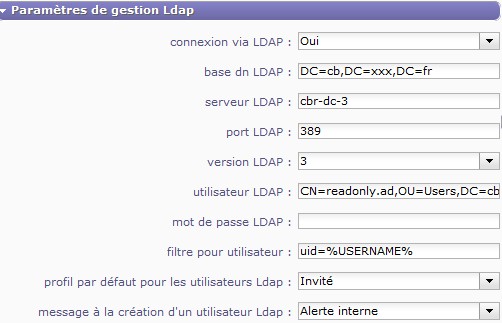

Allow me to put this new topic even if I've already seen an other topic for almost the same problem because I didn't find a solution.
After to have check all parameters, I have the following error :
2014-01-07 11:51:22 ***** ERROR ***** cause = ldap_bind(): Unable to bind to server: Can't contact LDAP server
Thank you for your help
Yannick

2014-01-22 16:55:14 ***** ERROR ***** ERROR *****
2014-01-22 16:55:14 ***** ERROR ***** on file 'E:\wamp\www\projeqtor\model\User.php' at line (746)
2014-01-22 16:55:14 ***** ERROR ***** cause = ldap_bind(): Unable to bind to server: Can't contact LDAP server
I don't understand why the parameters used by ldap connection don't correspond with the parameter that i put with the global parameter screen.
Thank you
22 Jan 2014 17:44 #6 by babynus
Replied by babynus on topic Pb ldap_bind to server
please check your parameters.php file : if the parameter exists in this file, it preceeds value in the database (as of config screen).
