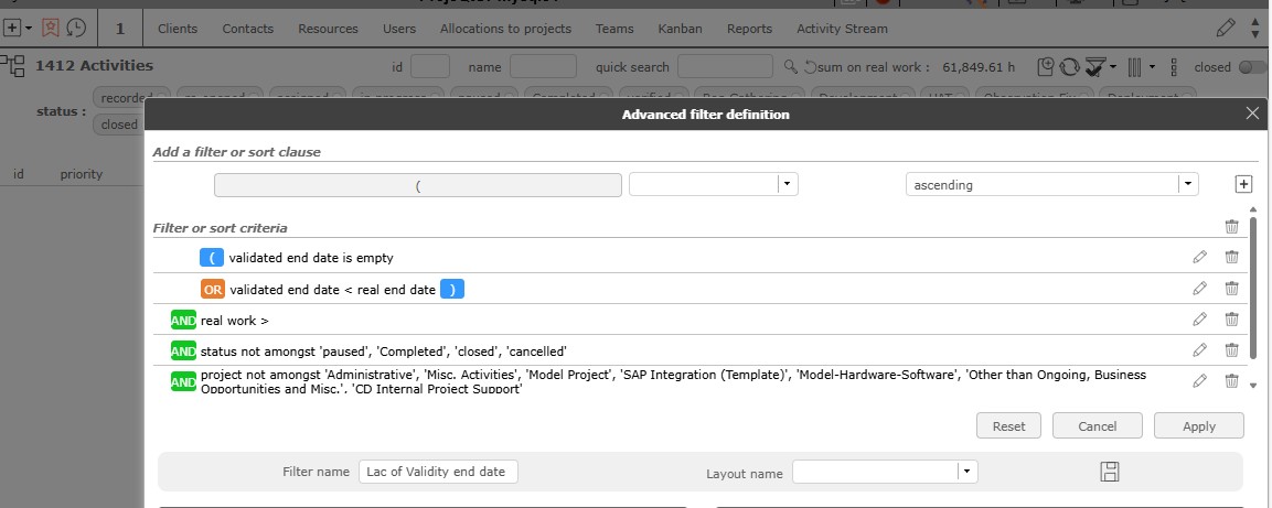

After creation of filter, I wanted to edit with by adding one more "AND" condition, but there is no option showing there. Please refer to the attached image.

Which version are you using?
Errors in the JS console?
I cannot reproduce your case in the latest stable version.

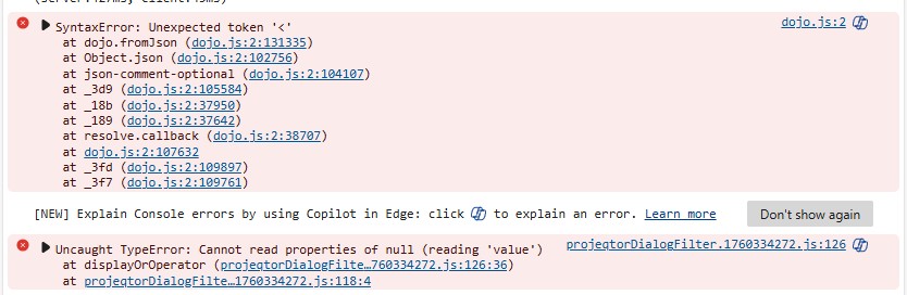

1. Version I am using is: 12.3.2.
2. Error in the JS console: Please refer the attached image.
Also find the below log recorded in ProjeQtOr:2025-10-23 11:45:49.509 ***** ERROR ***** [V12.3.2] [27] ERROR *****
2025-10-23 11:45:49.511 ***** ERROR ***** [V12.3.2] [27] on file 'C:\Apache24\htdocs\projeqtor\tool\jsonFunctions.php' at line (321)
2025-10-23 11:45:49.523 ***** ERROR ***** [V12.3.2] [27] cause = preg_match(): Passing null to parameter #2 ($subject) of type string is deprecated
2025-10-23 11:46:44.886 ***** ERROR ***** [V12.3.2] [27] ERROR *****
2025-10-23 11:46:44.889 ***** ERROR ***** [V12.3.2] [27] on file 'C:\Apache24\htdocs\projeqtor\tool\jsonFunctions.php' at line (321)
2025-10-23 11:46:44.890 ***** ERROR ***** [V12.3.2] [27] cause = preg_match(): Passing null to parameter #2 ($subject) of type string is deprecated

Thank you for this additional information. Unfortunately, I am unable to reproduce the issue, but I'm going to record the ticket. #10704
The PHP error has been corrected and does not cause the problem you are experiencing with the operator.
