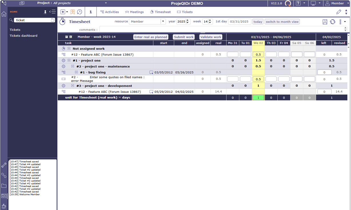

2. In section 'Treatment', click "Dispatch work" and clock out 1d for instance.
3. Go to Timesheet screen: the ticket does not appear, but the planning activity is displayed in a heading section "Work not assigned" (with the workload of 1d).

02 Apr 2025 10:55 - 02 Apr 2025 10:57 #3 by John K.
Thank you for your quick answer,
I cannot see any error in the browser logs (and I cannot access the server logs).
I reproduced my problem on the Demo environment, as recommended. Please check Timesheet for user "Member" with activity #12 and ticket #4.
To give more context, I'm gathering different dev/technical tasks (tickets) into a feature task (activity). So that I can have more details on the workload of the different parts of the feature, without having to create 1 activity per dev task.
