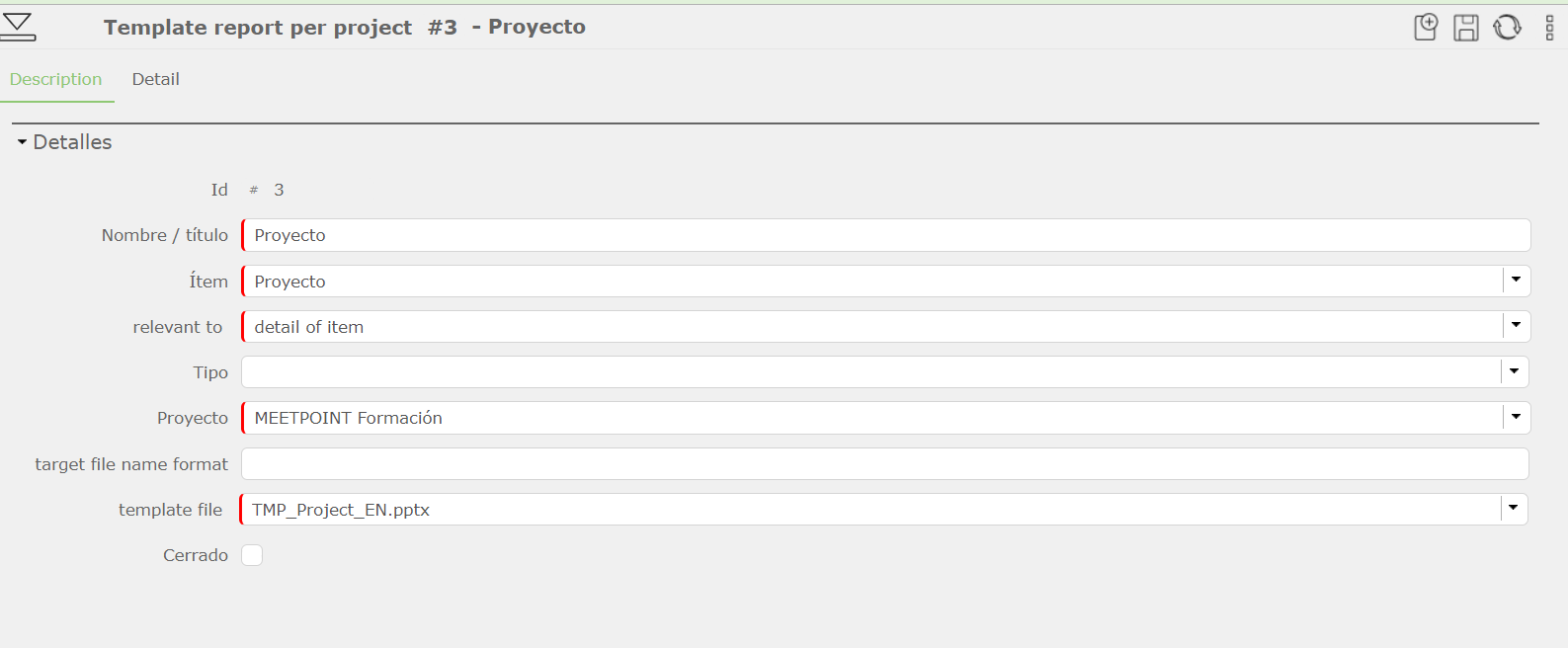

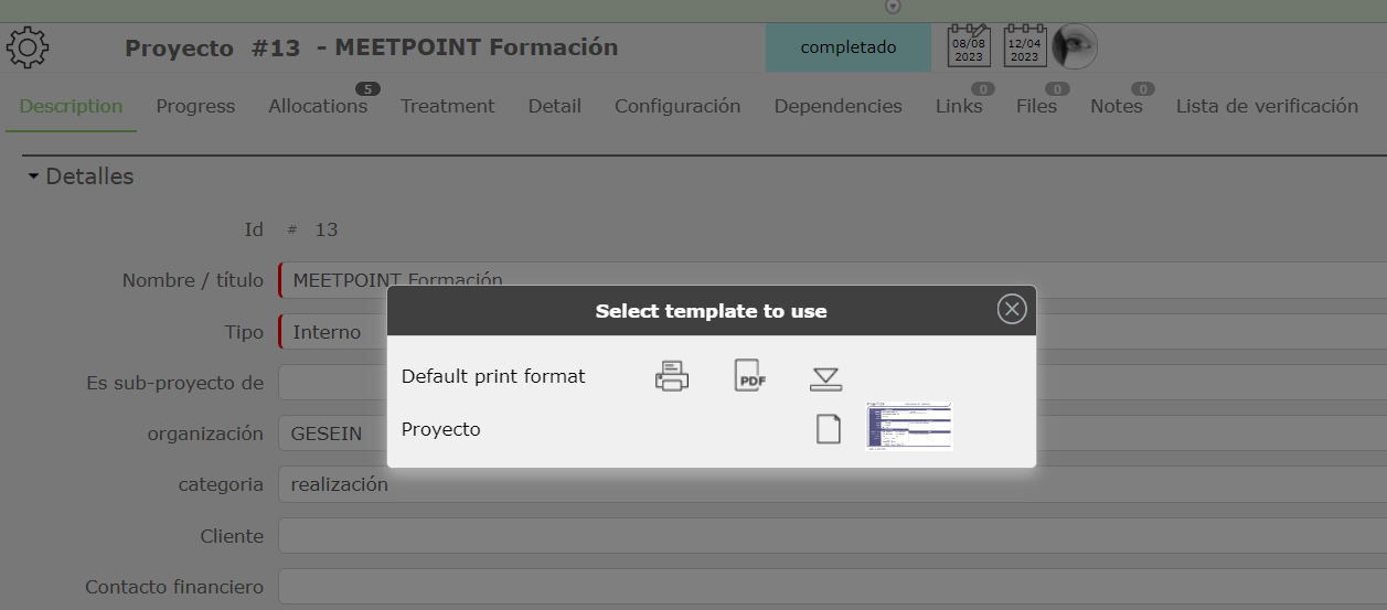

The problem seems to be that it lets me save the template, without choosing a template, and that is why it gives an error. But now I have another error, in projects, I choose projects, and I want a report with details and the TMP_Project_EN.pptx template.
It generates a file with a .powerpoint extension (which I attach as txt) and it gives an error in the log of a function.2023-11-23 14:05:18.799 ***** ERROR ***** [V11.0.2] ERROR *****
2023-11-23 14:05:18.802 ***** ERROR ***** [V11.0.2] on file 'C:\xampp\htdocs\projeqtor\external\tbs\plugins\tbs_plugin_opentbs.php' at line (1392)
2023-11-23 14:05:18.805 ***** ERROR ***** [V11.0.2] cause = Creation of dynamic property clsTbsLocator::$otbsDim is deprecated
2023-11-23 14:05:29.091 ..... SCRIPT .... 192.168.50.250 =====/projeqtor/view/refreshCronIconStatus.php
27 Nov 2023 10:24 #4 by Arkhanje
It seems that the plugin is not compatible with PHP 8.2. Try updating the previous version of PHP to see if the problem persists
