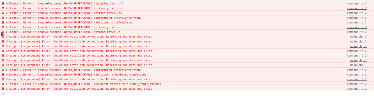

today i have updated to the last version v10.3.0.
After doing this, the application hangs after the login.
This is what the Developer-Tools says:
commons.js:2 Channel: Error in handleResponse UNK/SW_UNREACHABLE isLogsEnabled null
_handleResponsePromise @ commons.js:2
commons.js:2 Channel: Error in handleResponse UNK/SW_UNREACHABLE options getValues
commons.js:2 Channel: Error in handleResponse UNK/SW_UNREACHABLE contextMenu createContextMenu
commons.js:2 Channel: Error in handleResponse UNK/SW_UNREACHABLE tabClipper initCompleted
main.php:1 Uncaught (in promise) Error: Could not establish connection. Receiving end does not exist.
commons.js:2 Uncaught (in promise) Error: Could not establish connection. Receiving end does not exist.
commons.js:2 Channel: Error in handleResponse UNK/SW_UNREACHABLE tabClipper checkBackgroundStatus
commons.js:2 Channel: Error in handleResponse UNK/SW_UNREACHABLE broadcastEventToTab clipper_state_changed
Best regards
markus
