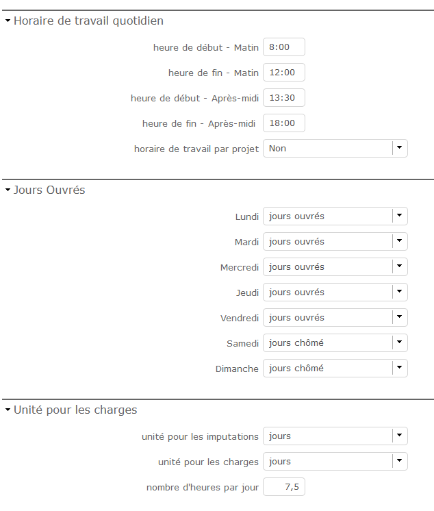

26 Sep 2022 13:07 - 26 Sep 2022 14:17 #8 by matthieu.froment
the working hours are defined since the beginning.
Here is a screenshot.
When I have filled the forms, I had a doubt with the number of hours per day : 7,5. I was asking me if it was possible.
Last edit: 26 Sep 2022 14:17 by matthieu.froment.
26 Sep 2022 15:39 - 26 Sep 2022 15:41 #9 by babynus
OK,
I found the issue.
It is due to bas management of munutes.
If you change 13:30 to 14:00, all will work fine.
We'll fix this.

26 Sep 2022 18:07 #10 by matthieu.froment
Confirmed, it's working but not aligned with my real working hours. Not a big issue.
