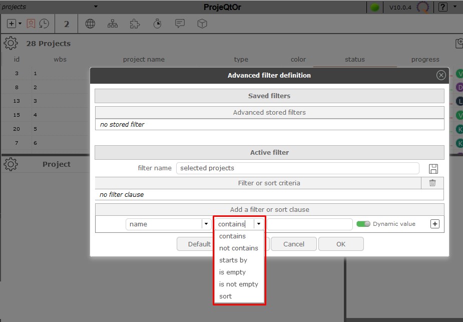

I am trying to make "Selected Projects" filter with dynamic filter feature, so it ask me to select projects from drop down to get required result.
But it is not showing values "amongst" & "not amongst" in the drop down list.
Please refer attachment.

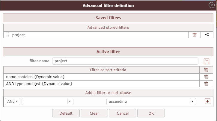

Make advanced filter:
"name", contains, Dynamic value
AND
"type", amongst, Dynamic value
I think the key point is that you forgot to click on the save disk next to the name
After that you can select sour filter and you will get a box and below you can select the type of project

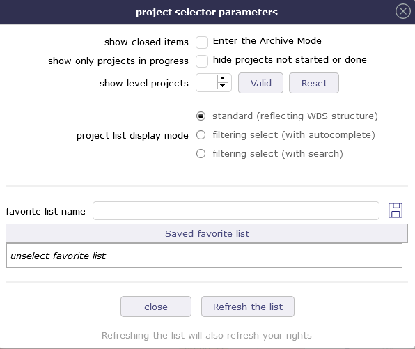

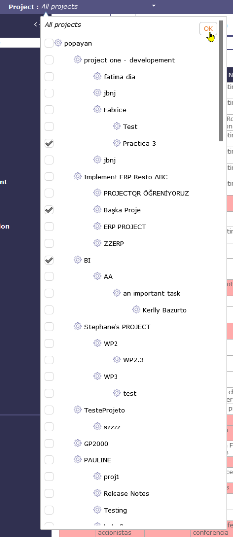

If you want to filter several projects with a drop down list, use the project selector in top left corner and use the setting "standard (reflecting WBS structure)"
Then you can checkmark several and click ok in the end

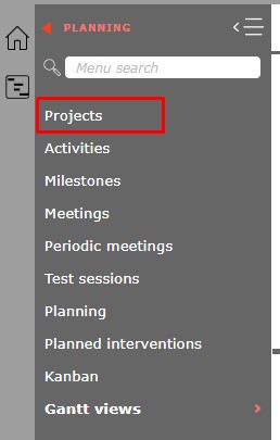

But please consider Image attached by me is not about what you understand, you are telling about top bar project selector & my question is not about that but it is regarding projects module which we select from LHS MENU to create/edit/view projects.
PFA for more reference.

Okay, though solution given by Coasterman was already known by me.
But I will manage to filter projects from top bar.
