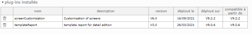

28 Jan 2022 14:45 #4 by CSO_Arnaud
Replied by CSO_Arnaud on topic v9.4.2 - custom screen
Thanks for your feedback,
But I use the last version !!!
what manipulation do you recommend, I reinstall the plugin?
28 Jan 2022 15:06 #5 by babynus
Replied by babynus on topic v9.4.2 - custom screen
Yes, you may try to reinstall.
Also try to remove existing customisation that may set the mess.
