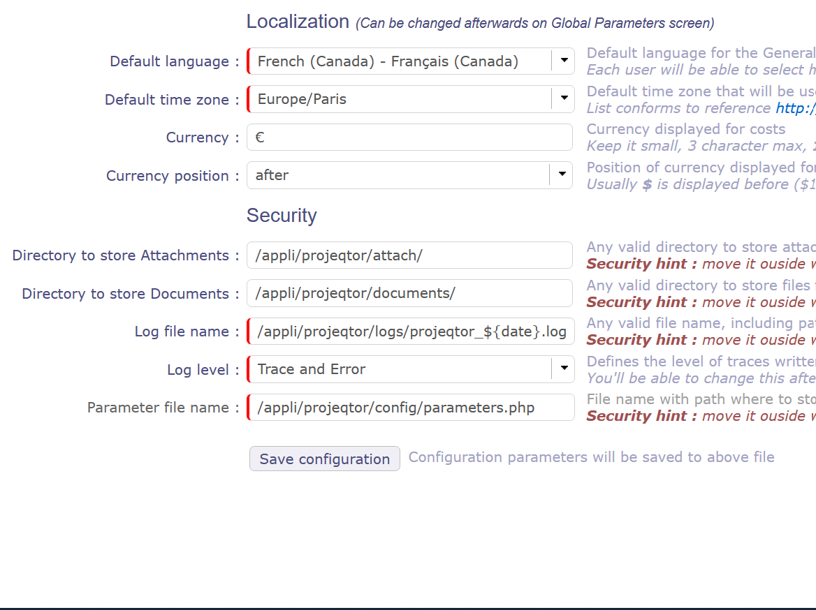

Hello teams,
I install from scratch ProjeQtOr v9.3.5 on Centos v8.5.211 / Apache v2.4.37-43 / Php v8.0.14-1 and all extension PHP need ProjeQtOr.
- In the first configuration, choice :
   - database MySQL the buton Save Configuration all items is OK.
   - database PostgreSQL the buton doesn't work (no effect, nothing)
I try to remove PHP-ZIP and reload HTTPD : the buton work for the choice database PostegreSQL but i have this message : Class ZipArchive is not available - You won't be able to manage plugins - check your php configuration (php.ini).
Impossible to terminate the first configuration !
PHP version is 8.0.14 : OK
Module PDO is available : OK
Module PDO for 'PGSQL' is available : OK
Module MBSTRING is available : OK
Module DOMDocument is available : OK
GD Library is available and correctly installed : OK
Module IMAP is available : OK
Module OPENSSL is available : OK
Module XML is available : OK
max_input_vars=4000 : OK
max_execution_time=30 : OK
memory_limit=512M : OK
file_uploads=1 : OK
session.auto_start is disabled : OK
register_globals is disabled : OK
Thanks for your support.
Stéphane
23 Dec 2021 15:17 #2 by babynus
ZIP missing message is not blocking : you can continue configuration.
If you're struck, possibly it's because you cannot create the postgres DB.
Try and created a db in postgres and use it.
23 Dec 2021 17:34 - 23 Dec 2021 17:38 #3 by smatou
Hi Babynus,
My database is install : PostgreSQL v10.17-2
The buton "Save Configuration" doesn't work (no effect, nothing).
I try on Edge and Firefox same issu.
I install projeqtor many times in past. But i have no idea.
I work at SOGETI/CAPGEMINI and now SCNF RESEAU
Last edit: 23 Dec 2021 17:38 by smatou.
23 Dec 2021 17:37 #4 by babynus
Check for errors in :
 - browser console
 - projeqtor log file
 - php error log file
- apache error log file
23 Dec 2021 17:56 - 23 Dec 2021 18:00 #5 by smatou
No log projeqtor !
