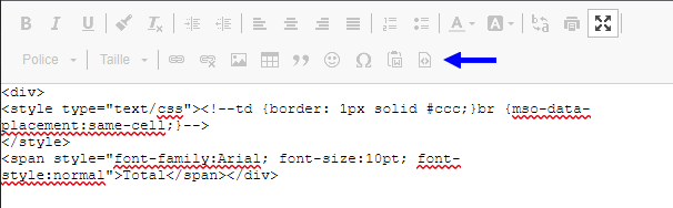

When we maximize a CKEditor field and then display the source  , then the system seems to crash :
  • Cannot exit source display :

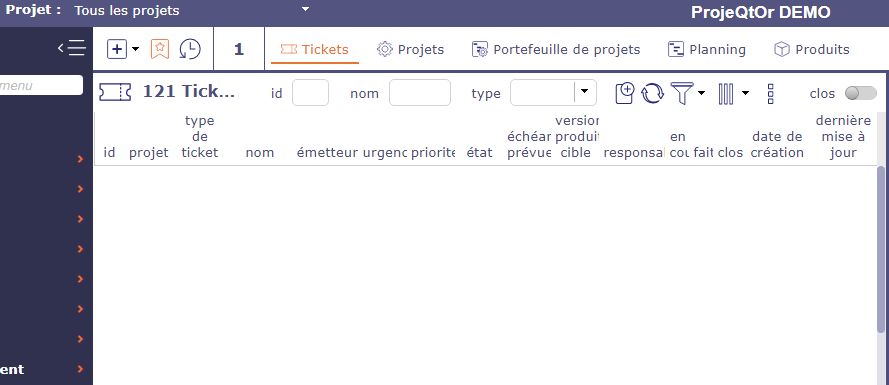

  • After leaving the full screen, ProjeQtOr no longer displays any content (refresh the element or use the menu to see it) :
You must then reconnect to restore a functional system.

Yes ... however, I just realized that strangely, the problem only occurs if this extension is active.

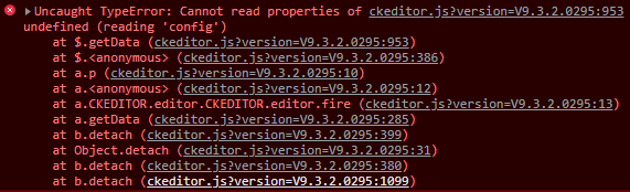

The problem is then possibly not ProjeQtOr (?)
For information I have this in the browser console when the problem occurs :
