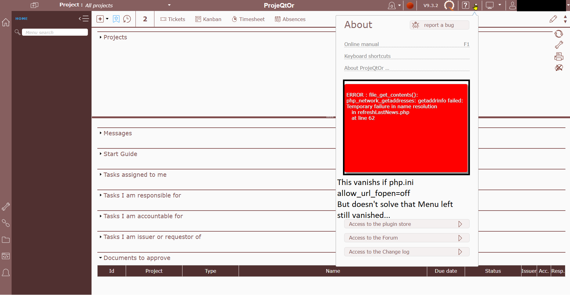

I've updated our virtual "offline" envirenment To V9.3.2 for testing
But the menu on the left side is missing.
See screenshot.

21 Oct 2021 17:48 #3 by Coasterman
Unfortunately this doesn't help...
Like php.ini --> allow_url_fopen=off the change of "getVersion" to No in the table parmameter just made the errormessage in the news section disapear.
But the left Menu didn't appear.
It is still hidden empty below "Menu search" and it doesn't matter what i click on the left side or if i show/hide the menu.
The links to the favorites are still working, but there i have also no access to the fault log, because i didn't put the administration in my favorites...

22 Oct 2021 11:12 - 22 Oct 2021 11:32 #5 by Coasterman
Strange behaviour...
I loaded the snapshot with V9.3.1 before the upgrade to V9.3.2 again and discovered that when i logged in (Username replaced with BlaAdmin), that the menu left was already vanished before the upgrade...
The last entry in the log ( 2021-10-15) was when i tested to the gantt issues with the "special user" (see my other post in the forum, userneame in the Log changed to Bla_guest) and then i didn't login again...
So today (2021-10-22) i logged in with the Adminaccount (BlaAdmin) and menu left did not show the content.
I Logged out, and logged in with the user (Bla_guest), this showed the menu, I logged out again, then logged in with the Admin (BlaAdmin) and the menu left was shown again.
After that i loaded an older snapshot with V9.2.2 and directly updgrade to V9.3.2 which was ok (so it has nothing to do with the upgrade process....)
The "recovery process" worked also with the snapshot of V9.3.2 which didn't show the menu left content.
Cookie problem ?!
After i tested this with Firefox i couldn't reproduce it after a certain time (in the beginning i could load different versions and simulate with different versions etc. ) but now when i go back it doesn't appear again.
But with the Edge browser where I had the same issue and did not play and login logout, i still have it (at the same time with Firefox i don't).

2021-10-22 12:42:48.549 ..... SCRIPT .... 192.168.56.1 getProfile(objectOrIdProject=Audit #109)
2021-10-22 12:43:01.771 ..... SCRIPT .... 192.168.56.1 =====/projeqtor/tool/storeLogLevel.php
2021-10-22 12:43:01.864 ..... SCRIPT .... 192.168.56.1 Page=storeLogLevel.php
2021-10-22 12:43:01.865 ..... SCRIPT .... 192.168.56.1 refreshParameters()
2021-10-22 12:43:01.971 ..... SCRIPT .... 192.168.56.1 getProfile(objectOrIdProject=Audit #109)
2021-10-22 12:43:01.996 ..... SCRIPT .... 192.168.56.1 getProfile(objectOrIdProject=Parameter #1766)
2021-10-22 12:43:01.996 ..... SCRIPT .... 192.168.56.1 securityGetAccessRightYesNo ( menuName=menuParameter, accessType=update, obj=Parameter #1766, user=User #3)
2021-10-22 12:43:01.997 ..... SCRIPT .... 192.168.56.1 securityGetAccessRight(menuName=menuParameter, accessType=update, obj=Parameter #1766, user=User #3)
2021-10-22 12:43:01.997 ..... SCRIPT .... 192.168.56.1 getAccessControlRights(obj=Parameter #1766)
2021-10-22 12:43:01.997 ..... SCRIPT .... 192.168.56.1 getProfile(objectOrIdProject=Parameter #1766)
2021-10-22 12:43:05.302 ===== TRACE ===== DISCONNECTED USER 'BlaAdmin'
2021-10-22 12:43:13.816
DEBUG
loginCheck : current db version = 'V9.3.1'
2021-10-22 12:43:13.832
DEBUG
User->authenticate('BlaAdmin', '5377cacb5463bc96ef94cc6e2606bbe64c89394e4fbc50e5ecbf72269e282550')
2021-10-22 12:43:13.837
DEBUG
User->authenticate : sha256 encryption
2021-10-22 12:43:13.838
DEBUG
User->authenticate : Successfull login
2021-10-22 12:43:14.069 ===== TRACE ===== NEW CONNECTED USER 'BlaAdmin'
2021-10-22 12:43:15.144 ===== TRACE ===== Cannot check Version at http:\\projeqtor.org/admin/getVersion.php
2021-10-22 12:43:15.144 ===== TRACE ===== Maybe allow_url_fopen is Off in php.ini...
2021-10-22 12:43:53.150 ===== TRACE ===== DISCONNECTED USER 'BlaAdmin'
2021-10-22 12:43:53.577 ***** ERROR ***** [V9.3.1] Exception-[23000] SQLSTATE[23000]: Integrity constraint violation: 1062 Duplicate entry '6j5p2g4cfu32l8r12iji0v7adf_20211022124353' for key 'auditSessionId'
2021-10-22 12:43:53.577 ***** ERROR ***** [V9.3.1]    For query : update audit set sessionId='6j5p2g4cfu32l8r12iji0v7adf_20211022124353' , disconnectionDateTime='2021-10-22 12:43:53' , idle='1'  where id=111
2021-10-22 12:43:53.577 ***** ERROR ***** [V9.3.1]    Strack trace :
2021-10-22 12:43:53.577 ***** ERROR ***** [V9.3.1]    #0 Sql->query called at [/var/www/projeqtor/model/persistence/SqlElement.php:1780]
2021-10-22 12:43:53.577 ***** ERROR ***** [V9.3.1]    #1 SqlElement->updateSqlElement called at [/var/www/projeqtor/model/persistence/SqlElement.php:1237]
2021-10-22 12:43:53.578 ***** ERROR ***** [V9.3.1]    #2 SqlElement->saveSqlElement called at [/var/www/projeqtor/model/persistence/SqlElement.php:820]
2021-10-22 12:43:53.578 ***** ERROR ***** [V9.3.1]    #3 SqlElement->save called at [/var/www/projeqtor/model/Audit.php:357]
2021-10-22 12:43:53.578 ***** ERROR ***** [V9.3.1]    #4 Audit->save called at [/var/www/projeqtor/model/Audit.php:230]
2021-10-22 12:43:53.578 ***** ERROR ***** [V9.3.1]    #5 Audit->finishSession called at [/var/www/projeqtor/tool/saveDataToSession.php:66]
2021-10-22 12:43:53.601 ===== TRACE ===== DISCONNECTED USER 'BlaAdmin'
2021-10-22 12:44:56.877
DEBUG
2021-10-22 12:44:56.892
DEBUG
User->authenticate('BlaAdmin', '14d99b611d39142048c098fdd9bd0262508fe854b7f1d9f0cc686db45e2027b5')
2021-10-22 12:44:56.897
DEBUG
DEBUG
2021-10-22 12:44:57.123 ===== TRACE ===== NEW CONNECTED USER 'BlaAdmin'
2021-10-22 12:44:58.178 ===== TRACE ===== Cannot check Version at http:\\projeqtor.org/admin/getVersion.php
2021-10-22 12:44:58.178 ===== TRACE ===== Maybe allow_url_fopen is Off in php.ini...
Last edit: 22 Oct 2021 11:32 by Coasterman.
22 Oct 2021 12:46 #6 by babynus
This can be a cache issue.
After upgrade, make sure to clean your browser cache.
When you change user, also be sure to have a clean disconnection (use disconnect button, not F5)
