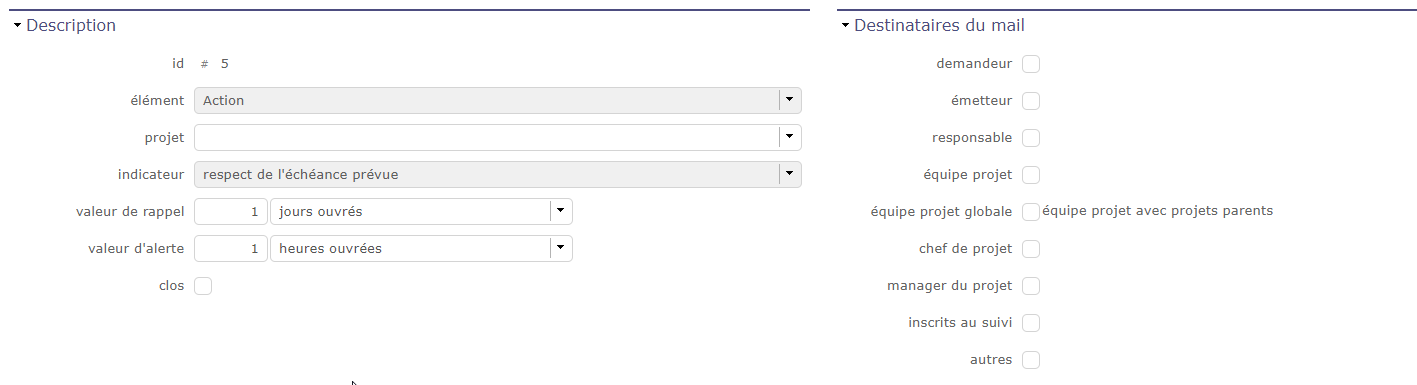

Indeed I had one indicator on action configured by an administrator in "Unitary Indicator" Menu.
Find below this indicator  screenshot.
Closing this indicator unblocks the problem. If Ire-open the indicator, then the problem comes back.
I tried to reproduce on demo but no account seems to allow accessing the "Unitary Indicator" menu.
Anyway i now have a workarround available as this indicator is not used.
