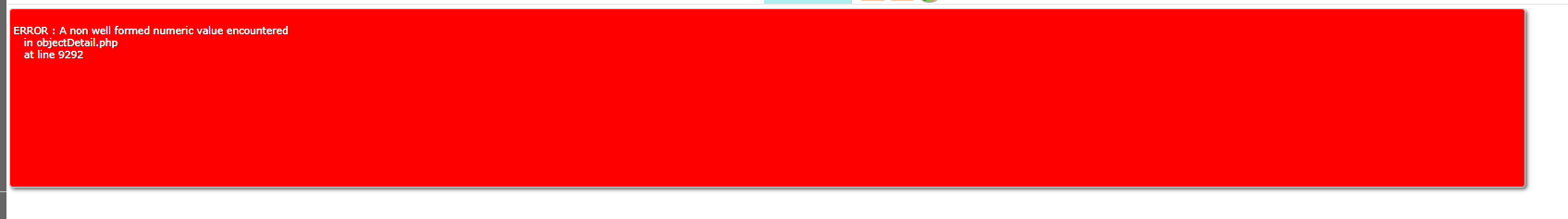

My version is of projeqtor is v9.1.3.
When I put a zoom on my navigator I have an error on the application.
I need to let my zoom at 100%.

10 Jun 2021 11:37 #5 by abarbier35
For information, we have not the same problem with our application with PHP 7.1.
If we used projeqtor in PHP7.4 we have this problem.
No problem with your demo application.
We use EDGE.
11 Jun 2021 10:59 - 11 Jun 2021 10:59 #6 by Flou
We cannot reproduce, but we have implemented a workaround that will normally resolve your issue in V9.2.
Version 9.2 will normally be available at the end of next week.
