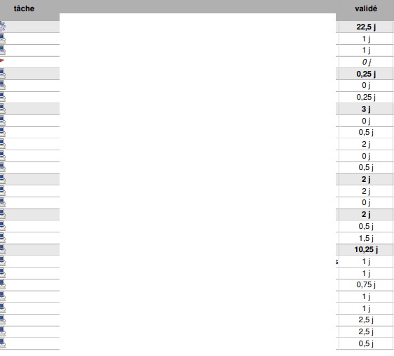

i would to suggest you what seems to be a bug (v9.1.3). I have a projeqt with validated work and when i use the report "rapports / charges consommés / synthèse des activités par charge" (sorry not sure of the labels in english), i have this result :
The total is 22,5 j but if made the calcul manually i have : 1 + 1 + 0,25 + 3 + 2 + 2 + 10,25 = 19,5.
Did i miss something ? Thanks for your help.

Indeed after recount validated work sum its not good,
we create ticket #5506 to fixe this.

This report only writes what is stored on items, so I don't think there may be an issue.
Maybe validated work on project sums some items that are not visible.
For instance, if you did not check "show visible items" closed tasks are not visible but thay are summed up on the project.

you were right i had an activity that was closed with 3 days of validated work.
thanks for the answers to both of you.
