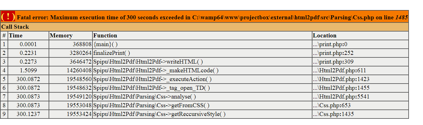

after many minutes, i have this message in the attached file( print) in the screen.

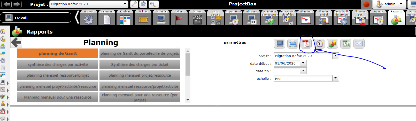

However i can't get the pdf generation from reports menu, i circle the action done in the action.png
in the php_error.log i get these lines:
08-Sep-2020 15:56:45 Europe/Paris] PHP Fatal error: Maximum execution time of 300 seconds exceeded in C:\wamp64\www\projectbox\external\html2pdf\src\Parsing\Css.php on line 1485
[08-Sep-2020 15:56:45 Europe/Paris] PHP Stack trace:
[08-Sep-2020 15:56:45 Europe/Paris] PHP 1. {main}() C:\wamp64\www\projectbox\view\print.php:0
[08-Sep-2020 15:56:45 Europe/Paris] PHP 2. finalizePrint() C:\wamp64\www\projectbox\view\print.php:252
[08-Sep-2020 15:56:45 Europe/Paris] PHP 3. Spipu\Html2Pdf\Html2Pdf->writeHTML() C:\wamp64\www\projectbox\view\print.php:309
[08-Sep-2020 15:56:45 Europe/Paris] PHP 4. Spipu\Html2Pdf\Html2Pdf->_makeHTMLcode() C:\wamp64\www\projectbox\external\html2pdf\src\Html2Pdf.php:611
[08-Sep-2020 15:56:45 Europe/Paris] PHP 5. Spipu\Html2Pdf\Html2Pdf->_executeAction() C:\wamp64\www\projectbox\external\html2pdf\src\Html2Pdf.php:1423
[08-Sep-2020 15:56:45 Europe/Paris] PHP 6. Spipu\Html2Pdf\Html2Pdf->_tag_open_TD() C:\wamp64\www\projectbox\external\html2pdf\src\Html2Pdf.php:1455
[08-Sep-2020 15:56:45 Europe/Paris] PHP 7. Spipu\Html2Pdf\Parsing\Css->analyse() C:\wamp64\www\projectbox\external\html2pdf\src\Html2Pdf.php:5541
[08-Sep-2020 15:56:45 Europe/Paris] PHP 8. Spipu\Html2Pdf\Parsing\Css->getFromCSS() C:\wamp64\www\projectbox\external\html2pdf\src\Parsing\Css.php:653
[08-Sep-2020 15:56:45 Europe/Paris] PHP 9. Spipu\Html2Pdf\Parsing\Css->getReccursiveStyle() C:\wamp64\www\projectbox\external\html2pdf\src\Parsing\Css.php:1435

08 Sep 2020 18:00 - 08 Sep 2020 18:01 #2 by babynus
Export of Gantt on Reports uses a very heavy way to export Gantt.
It is the "old" Gantt format (used on older version of ProjeQtOr) that use HTML tables to draw the Gantt.
Then the resulting Gantt chart is exported to PDF using HTML2PDF library. This is very slow and uses much memory on the server.
Fortunately we improved Gantt display on Gantt chart screen.
This does not use HTML tables any more but DIVs and so managed much less HTML dom nodes.
Also, we added a specific PDF export feature, that does not require server. All is done on Client side, and very quickly.
Also you can change page size and zoom ratio.
So please use PDF export on Gantt chart screen, not on Report screen.
