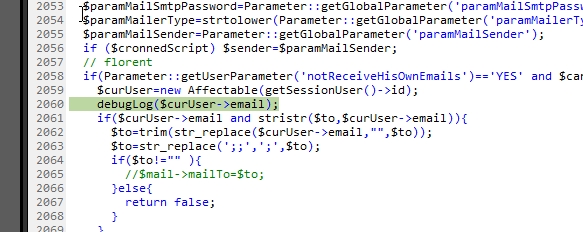

19 May 2020 02:46 #7 by iconic
I did exactly as you told me. Here is an image of what I did.
22 May 2020 16:50 #8 by babynus
And you changed
$logLevel='3';
in parameters.php ?
25 May 2020 00:47 #9 by iconic
Yes parameters is at 3.
25 May 2020 08:43 #10 by babynus
In fact logLevel is correct, as there are debug traces in the log file.
But executed code is not the one you changed.
In your printscreen of code, debug line in now in line 2060.
This pushes line with error in line 2061.
But error is still reported on line 2060.
So your change is not taken into account.
Please check that code is correctly updated.
Also try and restart PHP (come caching of code may occur).
