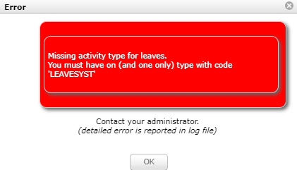

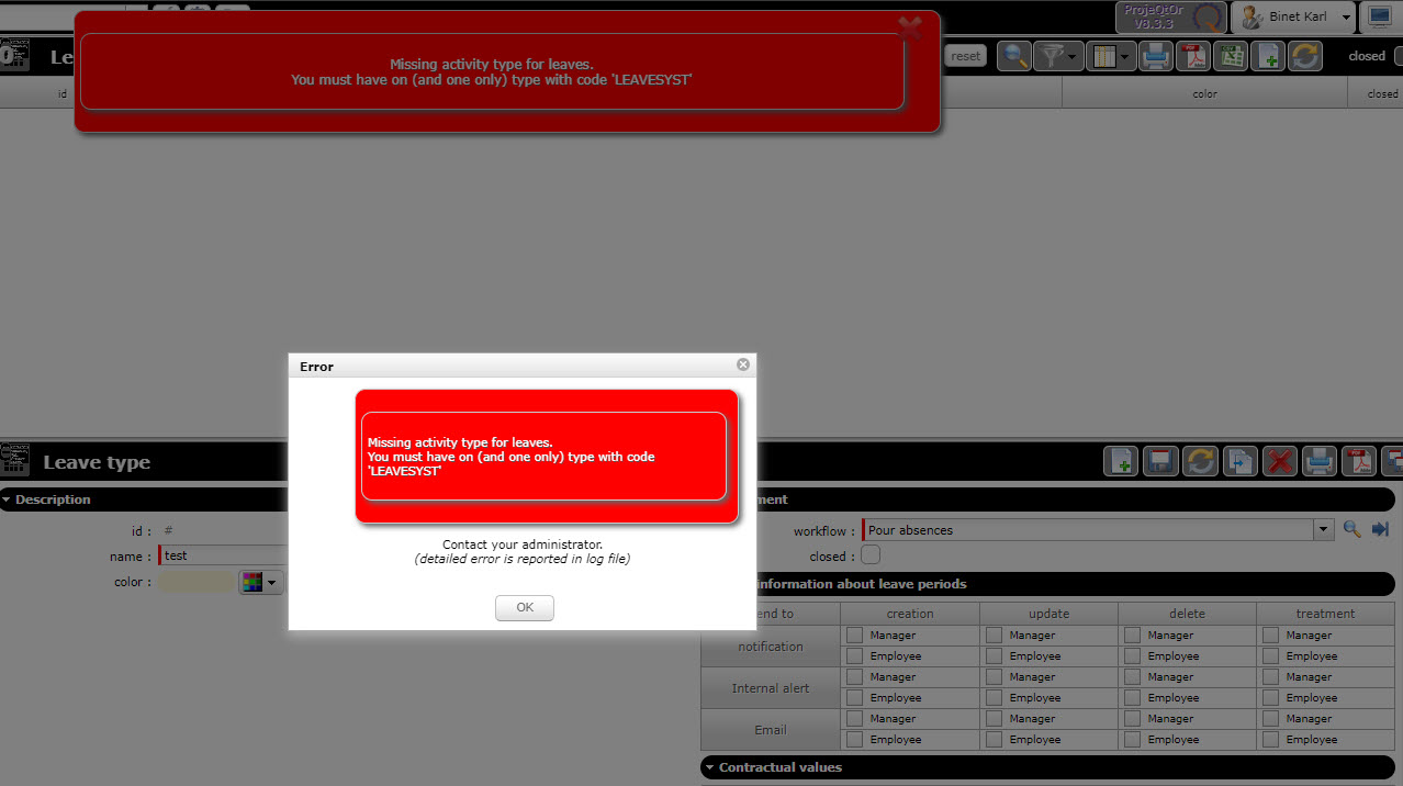

12 Mar 2020 14:12 #1 by karl.binet
i have V8.3.3,
I'm trying to configure the Leave module,
when i try to create a leave type i'm getting this error
From what i understand i need to create an activity type, but the code shown in error message can't by type in the code field in the activity type.
Can you help please

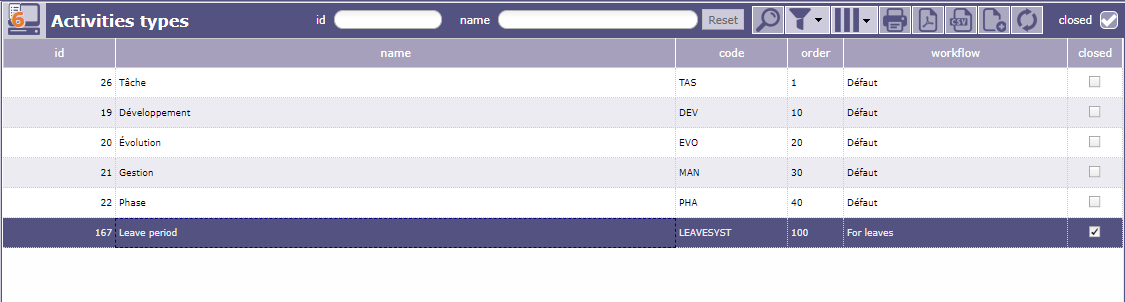

25 Mar 2020 15:50 #5 by babynus
Replied by babynus on topic Leave type creation error
Look at Atcivities Type.
Select "closed" checkbox to see closed type.
You must have one (and one only) type with code "LEAVESYST"
If you have several ones, delete extra ones
27 Mar 2020 13:41 #6 by karl.binet
see attach file for all my activity type,
I have only one type with code "leave"
i dot not have any type with the code "leavesyst"
