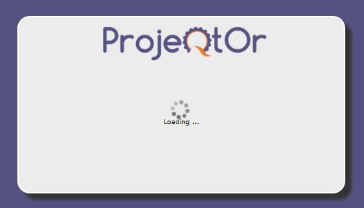

Since I saved my changes, the connection to the UI is no longer possible and the wheel keeps on spining.

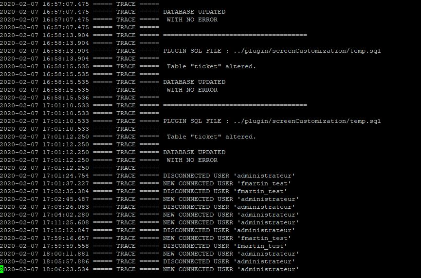

I checked logs and it seems the ALTER table that added a column in the ticket table is provoking log in and out in a loop.

With a higher level of rights (everything displayed), the wheel keeps on spining on log in page.
Is there a way to clear some cache or so ?

Please check projeqtor log file for errors and post any error here.
Possibly not error is logged at projeqtor level. You should then search for errors in PHP or Apache error log file.
Please post here any error found.
