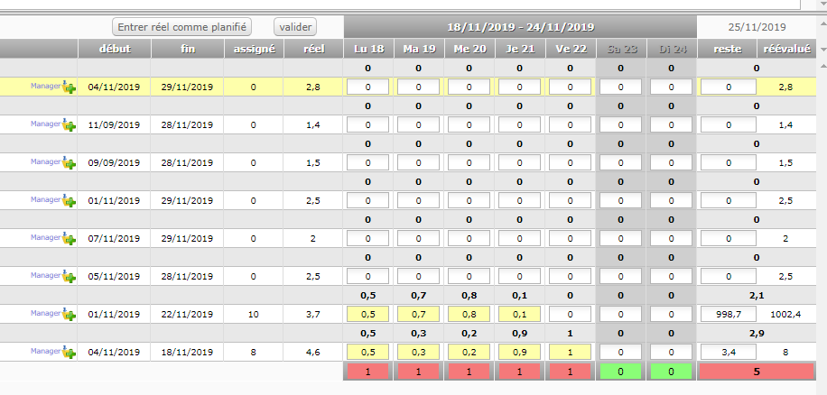

I am working on ProjeQtOr Release 8.1.5.
I face an issue while entering the daily charges.
The imputation result for the day loads go to red as soon as the value is greater than or equal to zero.
Normally, it should be the opposite: the day should go green when the day loads are equal to one.
I have an example attached to illustrate the issue.
Have you got a solution about this issue, please?
Thanks for your help,
Sid

Red color shows that resource has worked more than its FTE per day.
Please check for each resource their single FTP that could be let at a level less than 1 in your case.

Hello Alain,
Thank you very much for your answer which resolves my issue !
I have set up the FTE to 1 for each resource, and here are the results :
- the color turns to green for the daily loads when the daily sum is equal to one
- the color turns to red for the daily loads when the daily sum is more than one
- the color turns to grey for the daily loads when the daily sum is less than one
