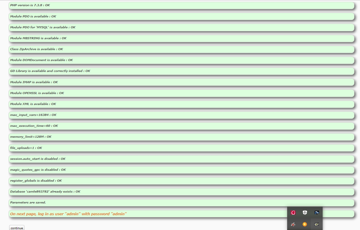

Installation messages tell me that everything is OK.

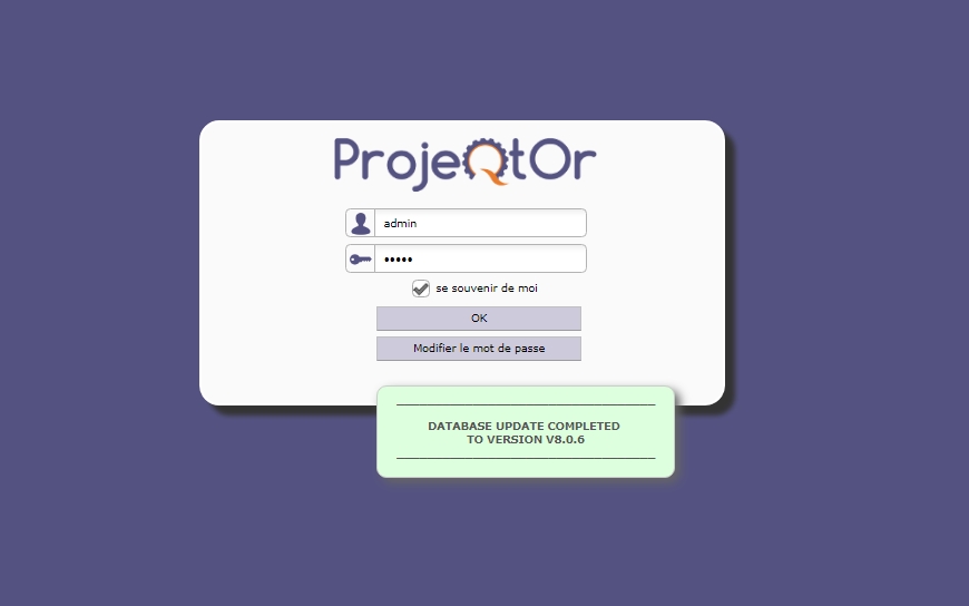

But when I try to connect with the initial credentials (admin/admin), the connexion is accepted then the site opens a blank page and nothing else.

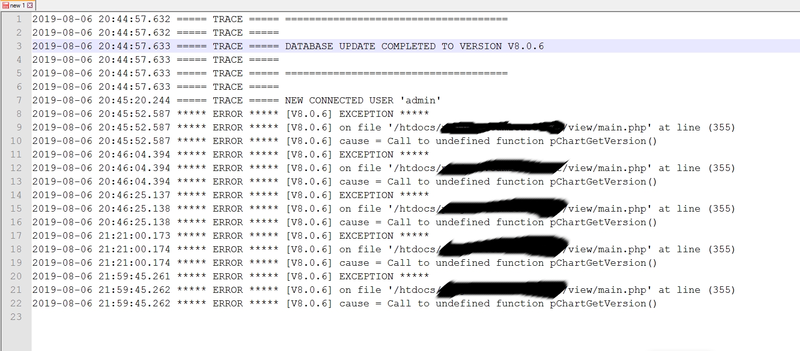

Something seems weird on your PHP setup.
Issue is on line 355 of file view/main.php :
aboutMessage+='&nbsp;&nbsp;.&nbsp;pChart2 : <?php include_once('../external/pChart2/getVersion.php');echo pChartGetVersion();?>'+'<br/>';
Error message says function pChartGetVersion() does not exist although it is defined in script external/pChart2/getVersion.php included just before.
Maybe it is due to sub-domain (virtualhost) definition.
