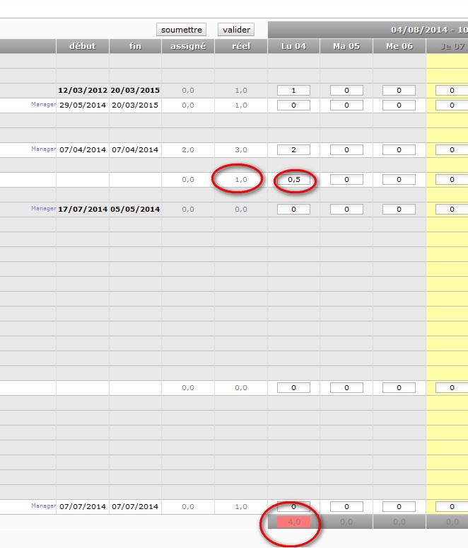

Hello there
There is a problem in accounting for hours at the daily total, when a charge of 0.5, the software comes on one account, it is also the case in the community release. if you come back one hour in a row +0.5 another in daily total was 2 and not 1, 5.
And if everything returns 0, it remains 1 in the daily total, it must leave the imputation and return it to be 0.
bonjour
Il y a un probleme dans la comptabilisation des heures au niveau du total journalier, quand on rentre une imputation en 0,5, le logiciel compte 1, c'est aussi le cas dans la version community. si on rentre 1 heure dans une ligne + 0,5 sur une autre au total journalier on a 2 et non 1 ,5.
Et si on repasse tout a 0, il reste toujours 1 dans le total journalier, il faut sortir des imputation et revenir dessus pour etre à 0.
Last edit: 07 Aug 2014 14:24 by protion.
07 Aug 2014 14:26 #2 by protion
image come community version
07 Aug 2014 20:06 #3 by babynus
It is a strange issue from Dojo 1.10.
First workaround is to retrieve Dojo framework from previous version (V4.3.3).
You must retrieve
/external/dijit
/external/dojo
/external/dojox
I'm looking for a more stable solution.
Patch will soon be deployed.
07 Aug 2014 20:37 #4 by babynus
Fix found !!!
In /model/ImputationLine.php, comment all lines (4) like :
//echo ' constraints="{pattern:\'###0.0#\'}"';
Patch V4.1.1 will soon be deployed
08 Aug 2014 00:33 #5 by babynus
V4.4.1 has been deployed
